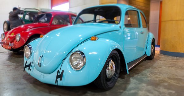

Welcome to Eircooled Mark, don't be afraid to join the club in attendance of some shows throughout the summer.
I sold these set of steels to Phil he got them powdercoated black, banded and threw them on his bug.
Really nice job.

Mikey, they weren't banded, they turned out to be 5.5j, he just painted them in the end.

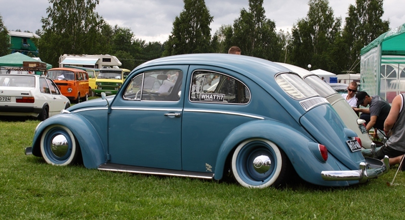

@Mark, I've 9 or 10j wide 5's on the back of my 62 with a bit of stretch they clear the wings with no mods. Depends on the look your going for too as you'll adjust tyre size to get it to sit right an clear wings. I probably wouldn't go more than 9j. I get you a pic of the wheels.

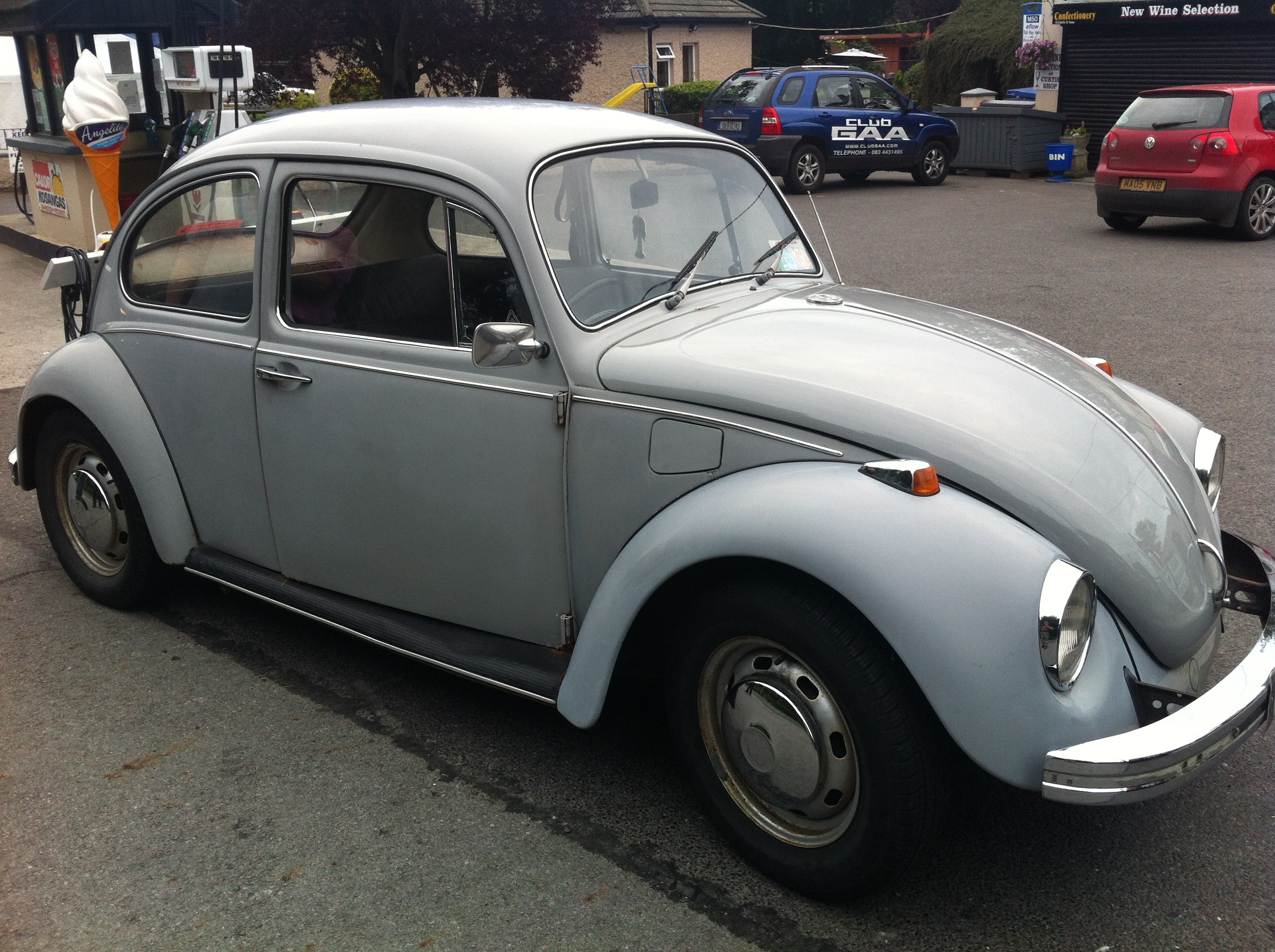

IMG_0861.JPG Here she is! Took my a while to figure out how to upload pics so this will have to do haha :) Thanks for all the reply lads means a lot! Hopefully when we have it done it will be going to a lot of vw meets :D

earlier cars have narrower rear axles so you can fit wider wheels to them .your car will have the longer axle shafts a tubes so that will restrict how wide you can go . unless you swap them if you can find a pair .

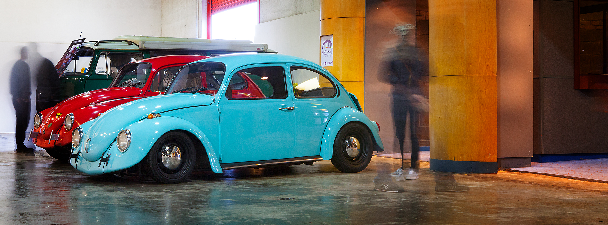

I was looking at getting banded wheels done but didn't bother in the end. I went with 5.5j wheels on the back with baby moon hub caps. I don't have any close up photos but you can see them ok in these ones
