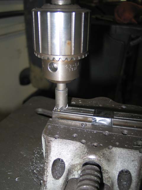

The best way to drill them is on a milling machine or a proper drill press. As they are hardened steel, the leaves will try and move when the drill hits them. You need to drill them SLOWLY, with a centre drill and then a drill with the correct angle to secure the grub screw.
It is a 15 minute job with the right gear. If you get them up to me i will drill them out for you.
Cheers, Paul.

cheers for the offer Paul. There is a local lad here who does bits for me, he has a a full on machine shop out the back of his house with 30ft long lathes and all sorts and I get him to do a few bits for me. Caddy posted pics a while back of doing the machining of the dimple and he used an old trailing arm to hold the spring plates tight, and then drilled through the grub screw hole - seemed like a good plan, so was going to give my guy the old trailing arm and let him use it the same way.
