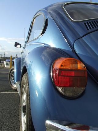

Here's another teaser
[/IMG]

I agree, looks like a great buy. Motors do come up for sale now and again, or you could ask Caddy to sort one for you.

Hugo's car, is a little gem. Its Irish, its a lovely colour not only in pictures but in the flesh.
The headliner is in great condition and the overall interior is in a very condition as you can
see in the pictures. We went for about 10 miles or so, from cold. It was a pocket rocket,
(that was till he fucked the engine, sorry Hugo had too!! LOL).
But it ran as sweet as a nut and was really nice. The steering was tight, it drove like an early
70's beetle should. Its your money, but with €2,500 Hugo's way.
Your going to have a car thats known in the scene, well kept after, Irish regged, and if you look after
it theirs no reason to see many years driving out of this little beauty.
