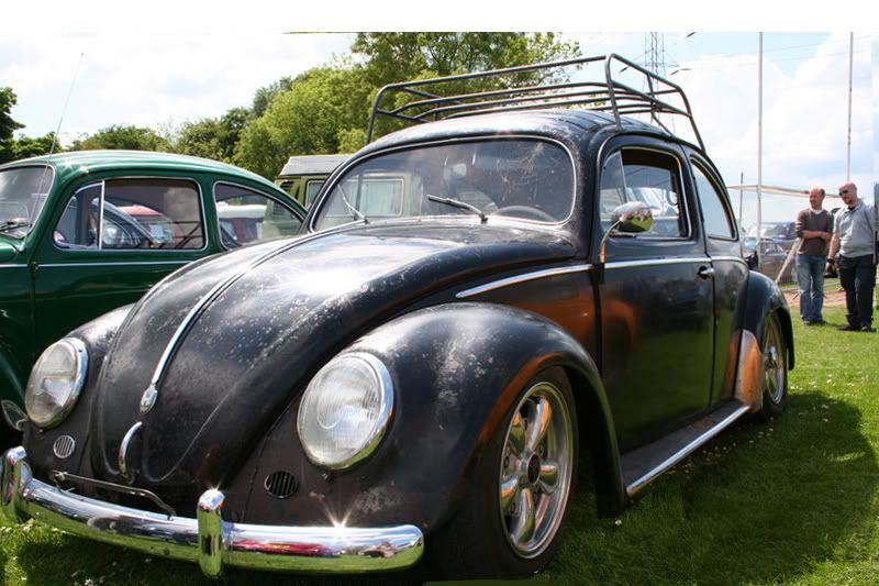

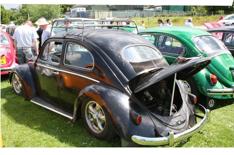

5 minutes in photoshop! easy! As I said, they are rough, but good enough to get the idea! I just lifted the pics off the Limerick show thread! Here's the before pic! Note the lil bit of camber too in the top pic!!
