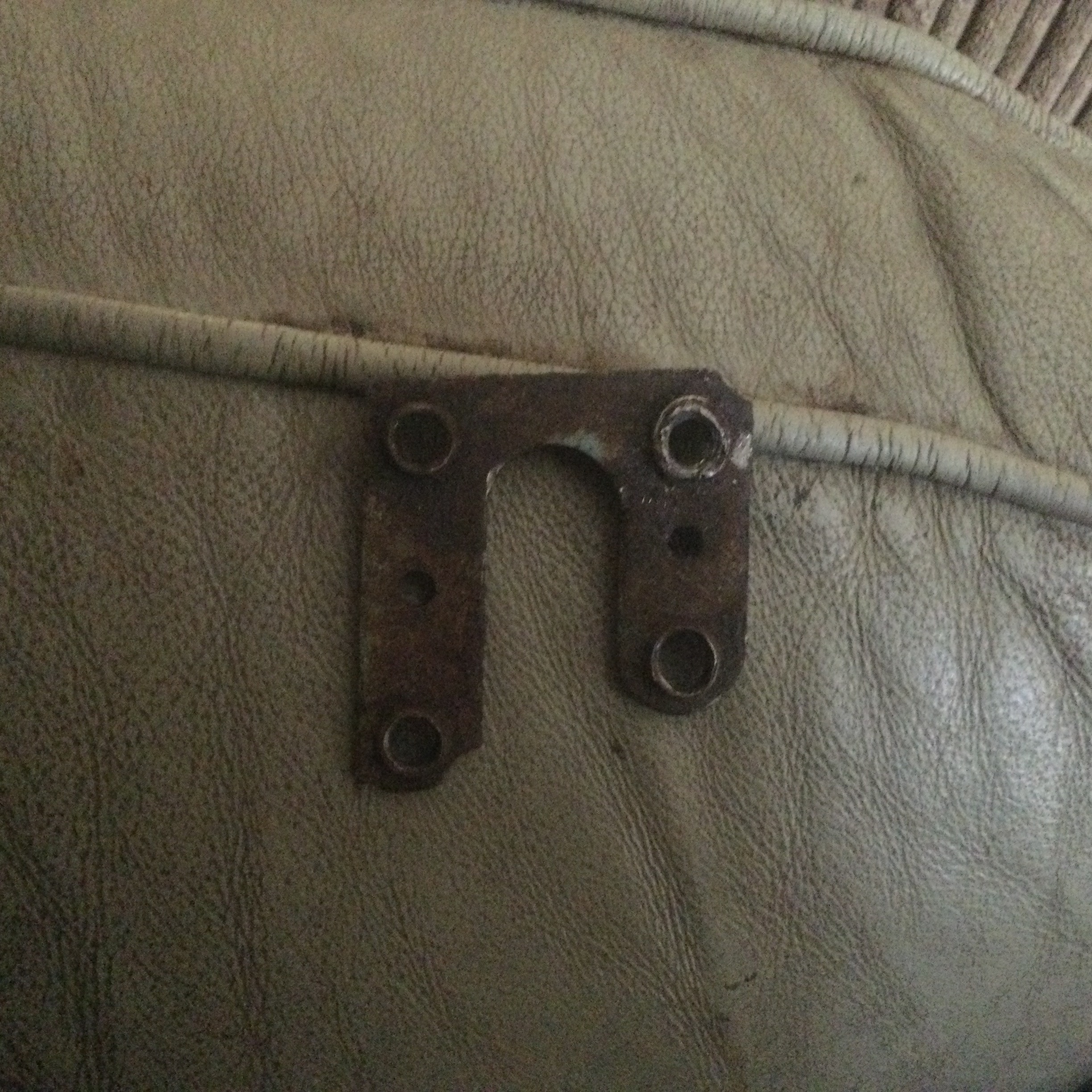

WANTED upper door hinge threaded plate

Has anyone got a pair of these for sale for the upper hinges on a 74 bug the same as in the pic. Work has stopped now :(

...I haven't bought anything from them but have bought bits of werk34.de who probably also stock them.
If you have a bit of the right sized 3mm plate or whatever, you can make up your own - drill a hole for 'the middle of the fingers' then cut up to that, drill n tap the hinge captive screw holes...
If you don't have a tap set, welding nuts onto the rear would do but you'll reduce the 'hinge plate' adjustment as the nuts will hinder the plates range of 'float'

Just looked and they have them but shipping is horrendous. The thickest metal I have is 2mm which is not quite thick enough. Auto craft do them when in stock
...a local engineering company will give you or sell you for pocket change an offcut whatever thickness you want, if you talk nice to them, you could bring the remains with you - they'd probably even have a cut near the size to save you cutting....
I've found the ones in A pillar repair panels, regardless of quality, are either too thin metalwise or the holes are slightly off when you try a hinge on them, so you end up making up your own anyways...
...free off the little securing strip, n scrap bin them, put in your own then weld back the wee securing sliver...
