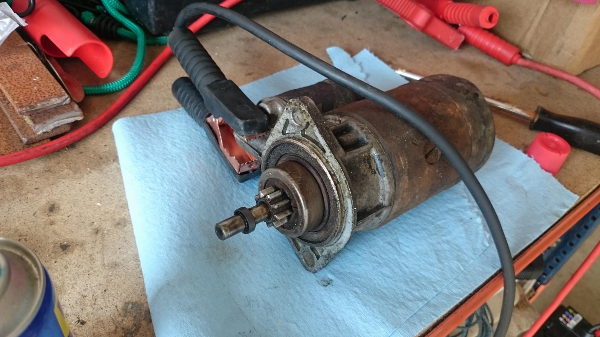

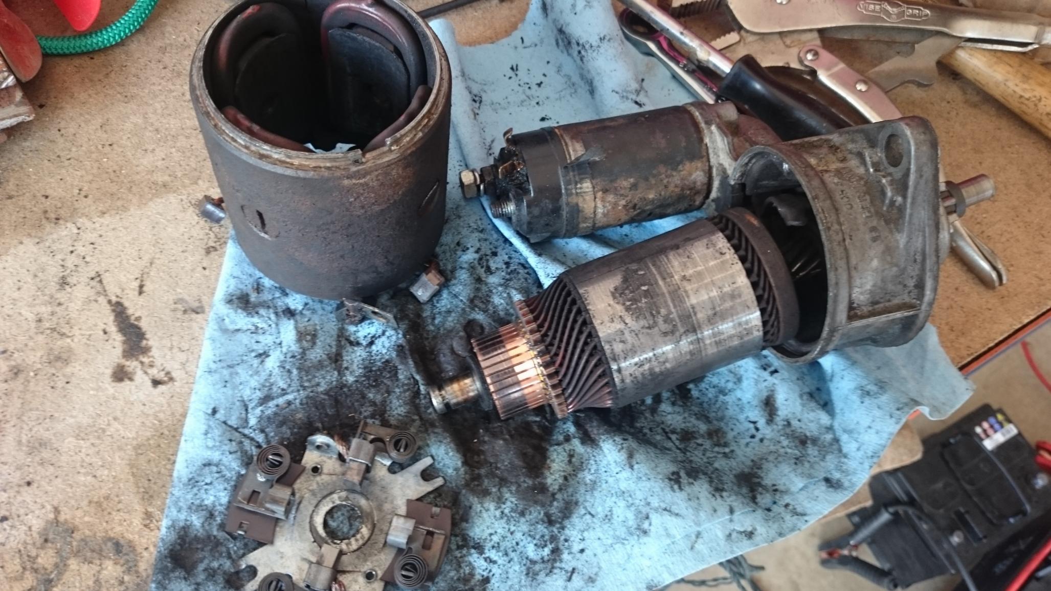

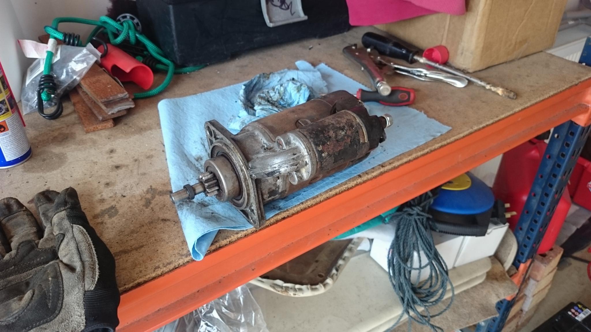

I did indeed and it produced nowt,
I pulled the starter out and bench tested it, no life at all, I stripped it down, it was full of grud, not a lot of life left in the brushes to be honest, I opened up the small receptacle which guides the brushes to allow the retaining spring to push them down a little further, so cleaned and regreased everything, bench tested again after reassembly and all good, reinstalled and it fired into life so all I'd right in the world. See how long it lasts lol.
