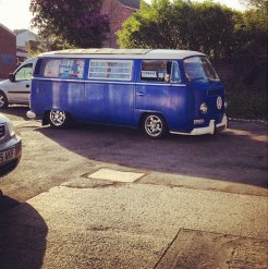

Thanks for that but I couldn't live with a van like that. I like having my beetle low but I use the van over every terrain so I only want to bring it down a couple of inches. Take a look at the pic below especially the bottom of the van against the gate. The rear has possibly sagged over the years and now it's nose high.

Both our buses are nose high. Shit I thought that was normal :D. Low does look über cool though
