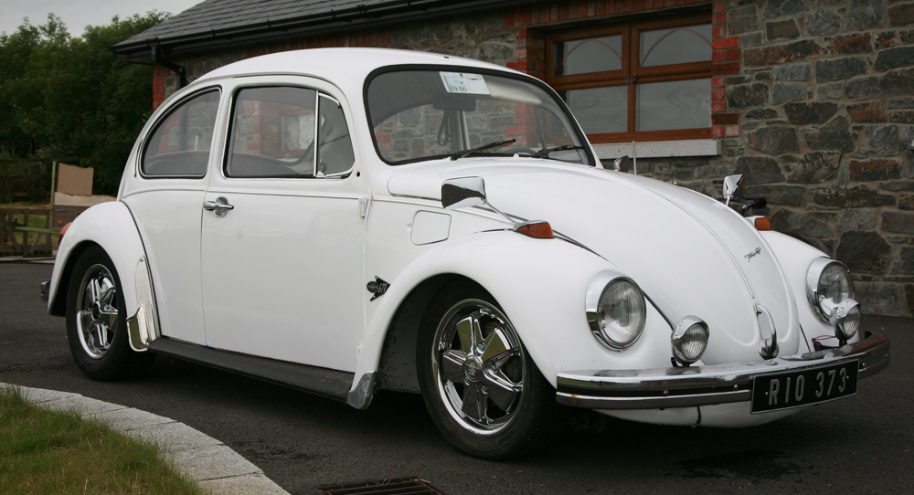

Your probably right, but this was my first beetle and I never really got to drive it after I restored it. For example its had the same tank of petrol in it for the last 7 years, as it only got used for a couple of weeks a year when I was back from Oz. I've not been back in 3 years so the brakes need re-doing. I might take your advice and just put some new wheel cylinders in and drive it!
Out of interest what would it be to narrow and weld in adjusters to that beam?
Cheers
Steve
