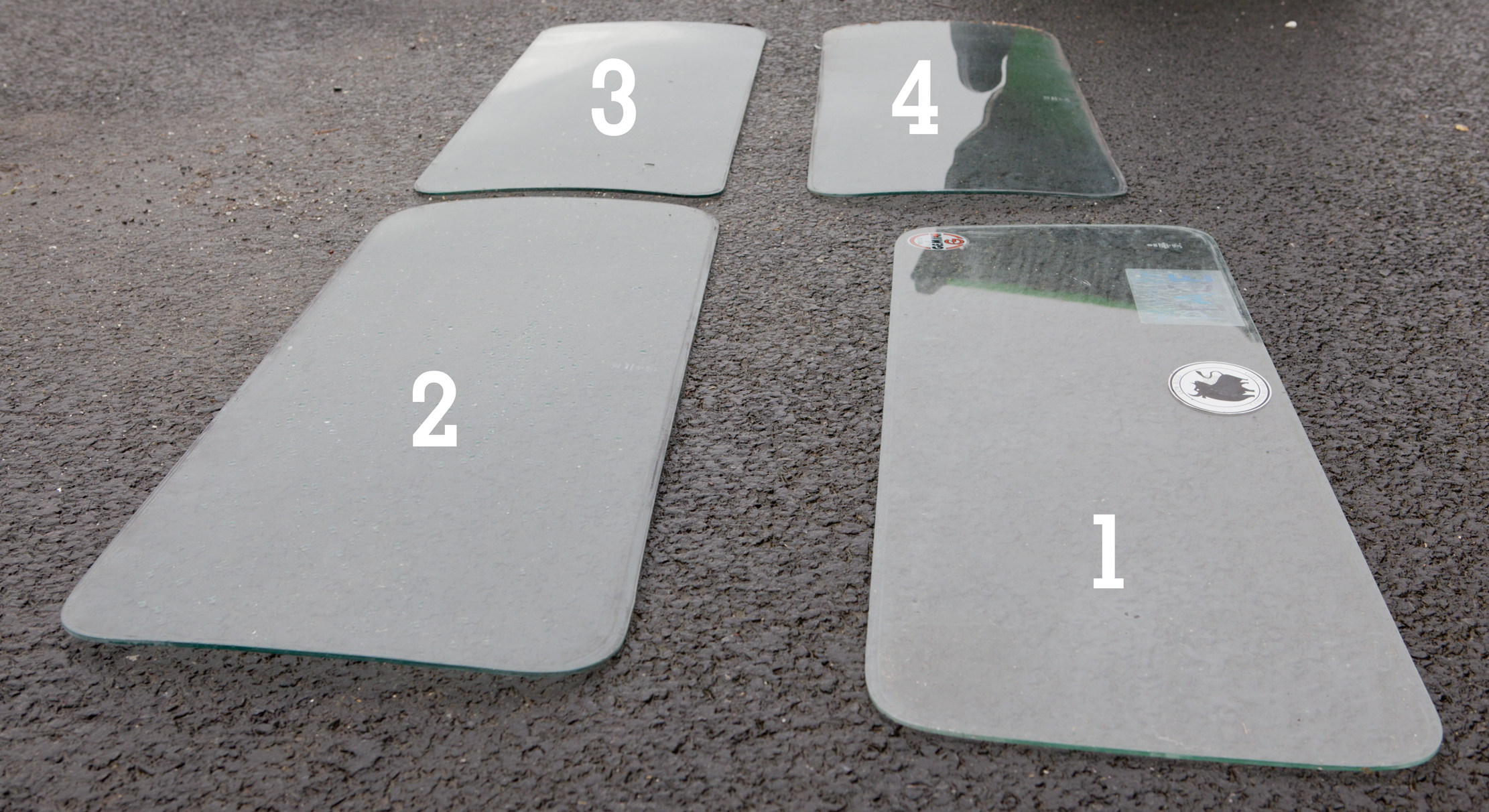

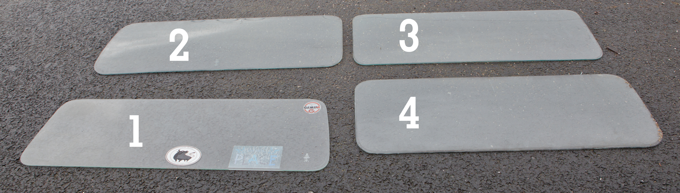

ok shane this is all i have
1 is the back window (i think) its flat
2 right hand side rear ( i think)
3 and 4 are the side windows behind the cab (i think)
*1 is flat
*2,3 and 4 are curved

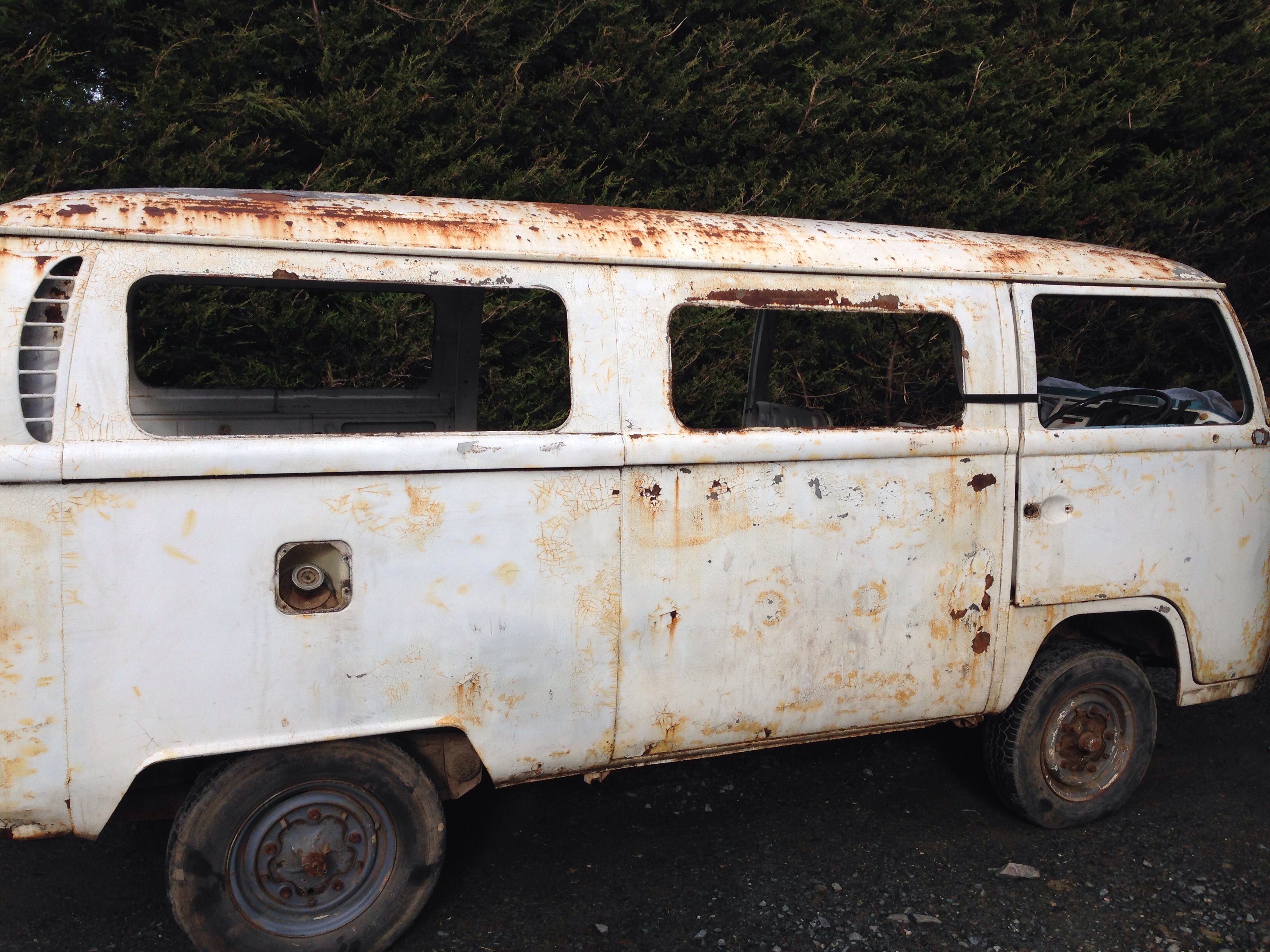

lol put the voodoo dolls and crows feet brew down will ya's!! 8) a guy has arrived here with a South African import with the worst window hack job I've seen, they're different sizes and heights, just trying to make it look better 8) sorry for not replying earlier, the forums have changed their mind and not alerting me of updates 8( gotta change again 8)

poor bus, rhd pre 71 panel would be high on the wish list. guess some window cuts are the best way of saving that yoke now. looks good and solid glwtr

Cheers Baz, yeah its a 70 South African import, with regards to windows, are all bay windows, whether factory or converted panel van the same glass? I understand its different seals etc, but is the actual glass the same? Just trying to see for sure if stumps stuff above is right. Tbh I've no idea what I'm looking at. And is it supposed to be flat or curved?

You need the curved stuff to match the curved side of the van then use the converted panel rubber wit the spreader strip.
Vans with factorywindows have the glass recessed in from the curve of the body and so use flat glass.flat glass will go into the panel but won't as well as the curved glass.
I am looking for a middle and 2 rear curved glass if anyone has any lying around.
