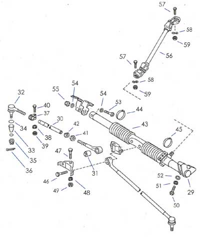

When I spoke to Cormac, he said there was no bracket in the centre on any of the racks he'd seen, and the tie rods bolted straight onto the rack. The picture below gives me the same impression, and now I'm thinking that maybe not every rack had that centre bracket thing. I don't even really understand what it's for.

here's a 1303 rack in a sbay window bus, it has the centre bracket:
and here's my Audi rack compared to your 1303 rack. As far as I can see the rack has bosses to locate and seal the rubber boot to keep the grease in, prevent it by being crushed compared to bolting the track rods directly to it and it also provides a point to bolt the steering damper to . Your 1303 won't have a steering damper so if you made some kind of spacer washer to go between the rods and the rack then you sould be good. You also need some way of locking the bolts securing the rods to prevent them from unwinding. Maybe lockwire would do in place of the little bend-over tabs on the Audi rack.

here's the ETKA page for the 1303 steering rack setup. Note the bracket is present unlike the diagram above. This being the official VAG document I'd go with that...

here's another 1303 rack complete with centre bracket. Recognise it?
what I'm trying to get at here is that VW fitted the bracket for a reason. I wouldn't be inclined to leave it out...
