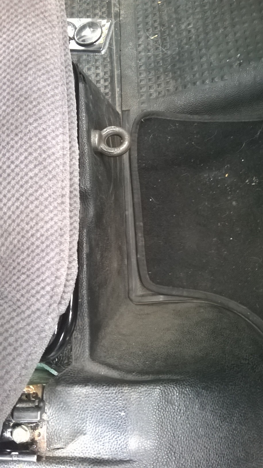

this is what i fitted to seat box the hole is already on a t3 so takes five mins on anything else you may
need a eight mill hole i used a nylock nut ( don't need to be adding rattles to these auld yolks)
i now put a bicycle cable/steel rope trough this and around steering
it's a lifting eye i got from prolift (irish chain and rope) i used to be a regular customer there
when worked for road safety company so this was a freebie (y)
