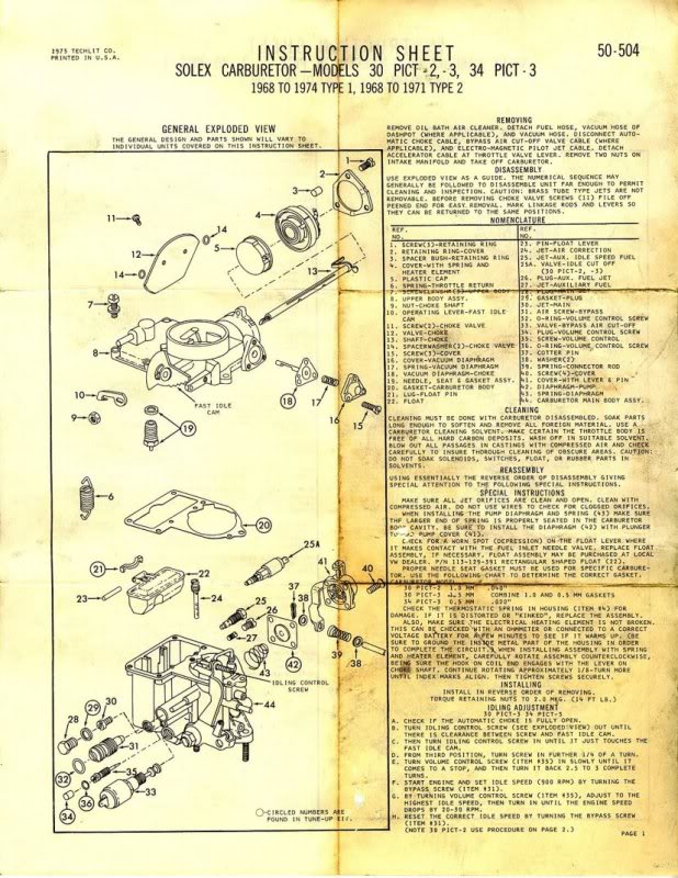

Maybe increase the idle jet one size, it might sort it.
1971-1974 34PICT/3 Carburetor
Venturi: 26mmPower (Auxiliary) Fuel Jet: 60
Main Jet: X127.5Float Needle Valve Diameter: 1.5mm
Air Correction Jet: 75Z (80Z for Ghia)Float Weight: 8.5 grams
Pilot (Idle) Jet: 55Accelerator Pump Feed: 1.3 - 1.6cc/stroke
Pilot Jet Air Bleed: 147.5Fuel Pump Delivery Pressure (max): 3 - 5 psi
Accelerator Pump Jet: 50Delivery Capacity (min): 400cc/min @ 4000 rpm
