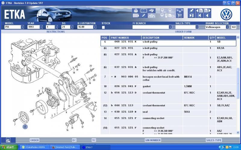

Thanks Trev, I assume its in order that the two belts can rotate at different speeds even though they are on the same drive so to speak...I have gleened the following info from vagcat.com.
068 121 028 117mm SB
026 121 031 133m RP EZ
068 121 031 K 116mm 1Y
028 121 031E 111mm AAZ
027 121 031A 105mm KR 9A
Thanks, Trev, Much Appreciated...

I googled up a pic of your pulley:
is that like what you have? There's no bearing in the centre, just the three bolt holes onto the water pump flange.

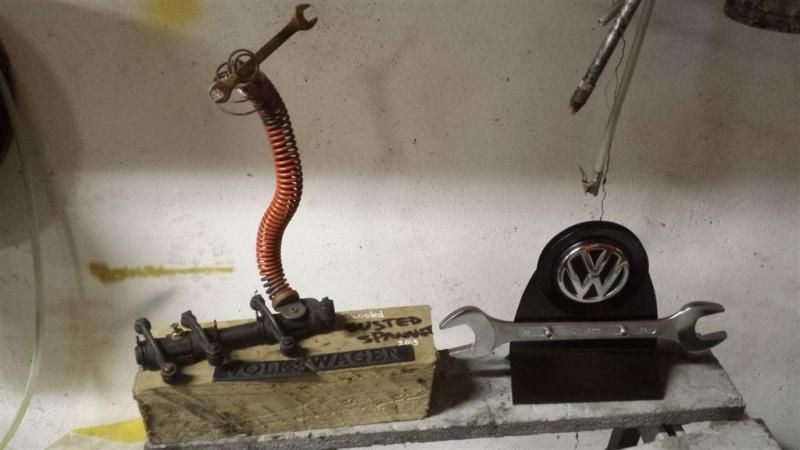

Anyway, we're splitting hairs here, I've had a root around the garage and remembered where the last vee belt pulley went:
that's it there on the right, 58panelyouny has it now :ROFLMAO:

rascal1
January 12, 2007
452
Marino, Dublin
And if that wonderful creation on the left is any use to you,you are more than welcome to all off it.
I was going to send it back to the manufacturers as the spanner fell off the spring....Shoddy work..
