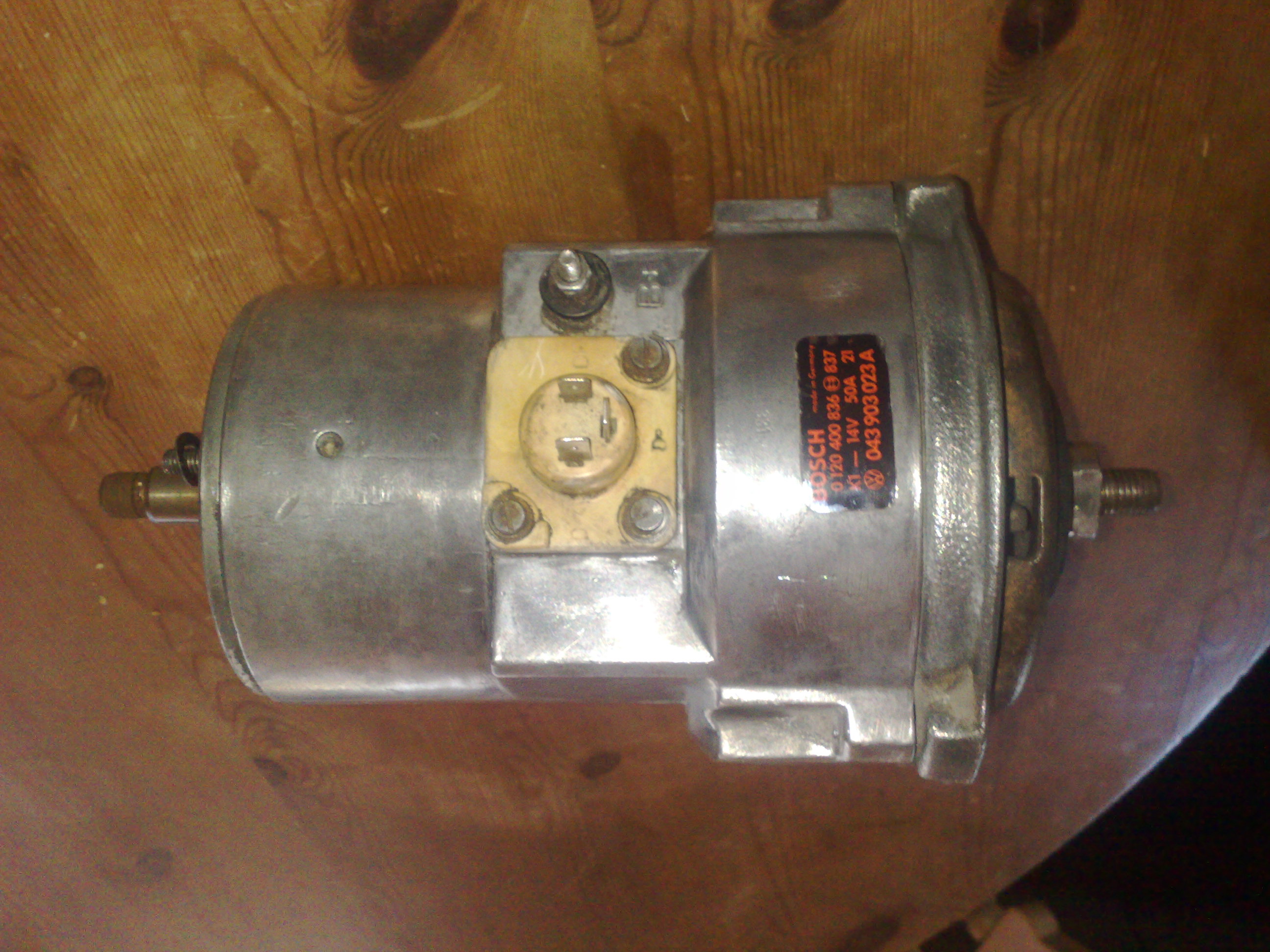

The attached alternator I think is the external regulator type, but maybe one of you can confirm this ?
If so I guess I need a regulator, and or connector plug to go on the connectors(Duh!)

as for the alternator, the internal one only has one post on it, the external has the three as you can see, one for earth, one for gen light and one big heavy red goes to regulator under back seat. there is a special plug for the top but its not essential, the crimps that everyone has do the job. the internal type has all the noggins inside and means you can just join the wires under the back seat, id go for one of those given opportunity, sometimes a second hand int alternator is cheaper than a new regulator.
