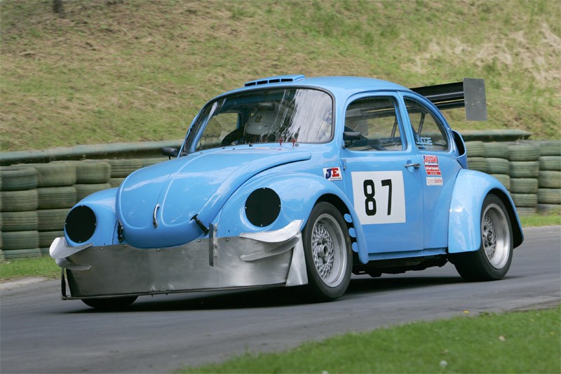

I've been trawling the Internet lately for information on good track prepped bugs, it's hard to get detailed information but there is a lot of people racing them an their not all 1303's either which is what I want to see.
I've just stumbled across the Copa Fusca and this guy Wessler Racing but so far I can't find a website but he seems to build mean race beetles.
This is his coolest...
https://www.facebook.com/media/set/?set=a.793694037312911.1073741838.100000169661793&type=3
14,126
2,216
I know it's an '03 but it sure is purposeful!!
