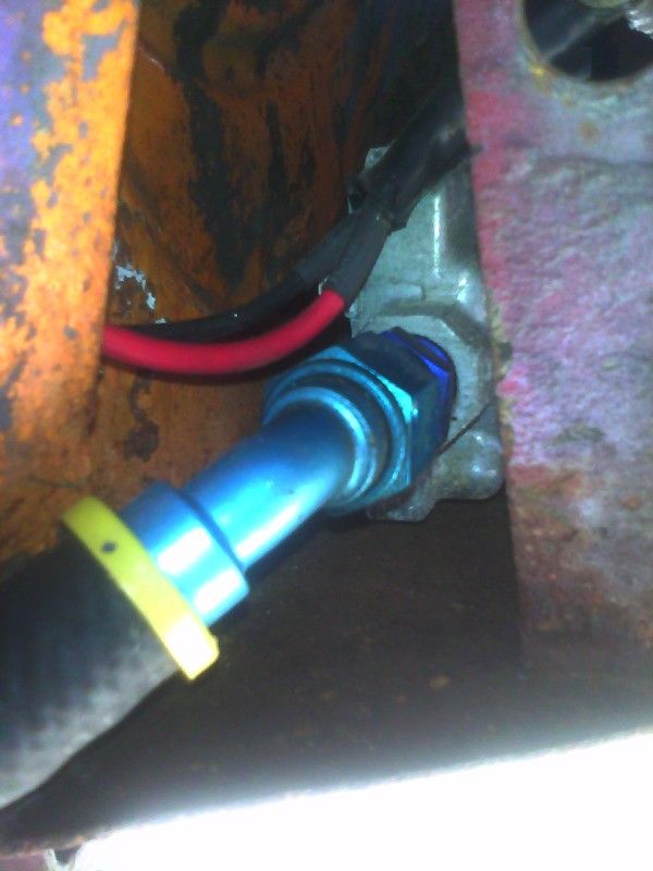

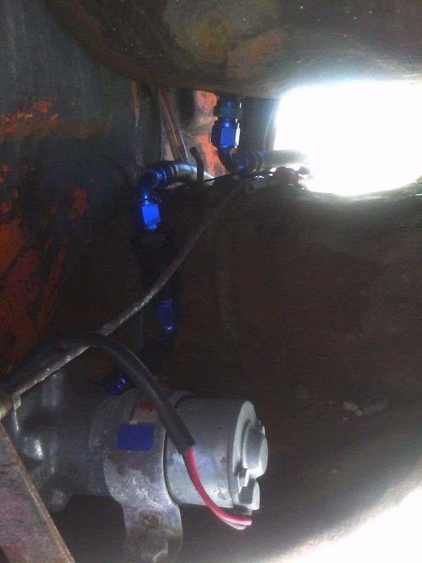

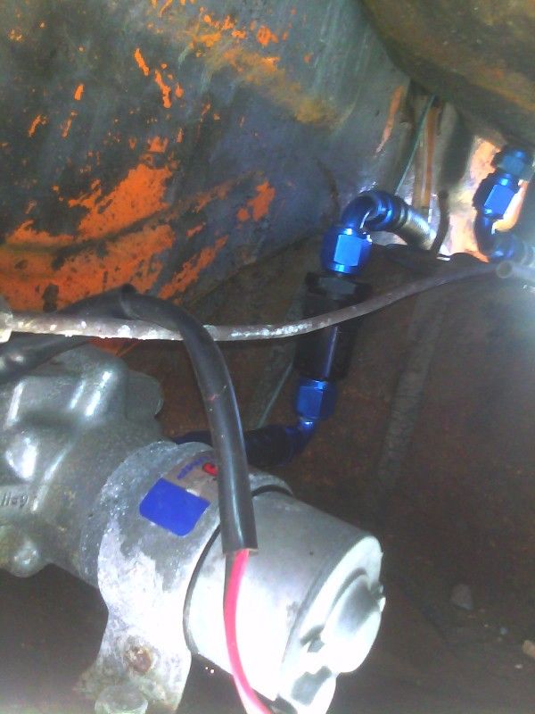

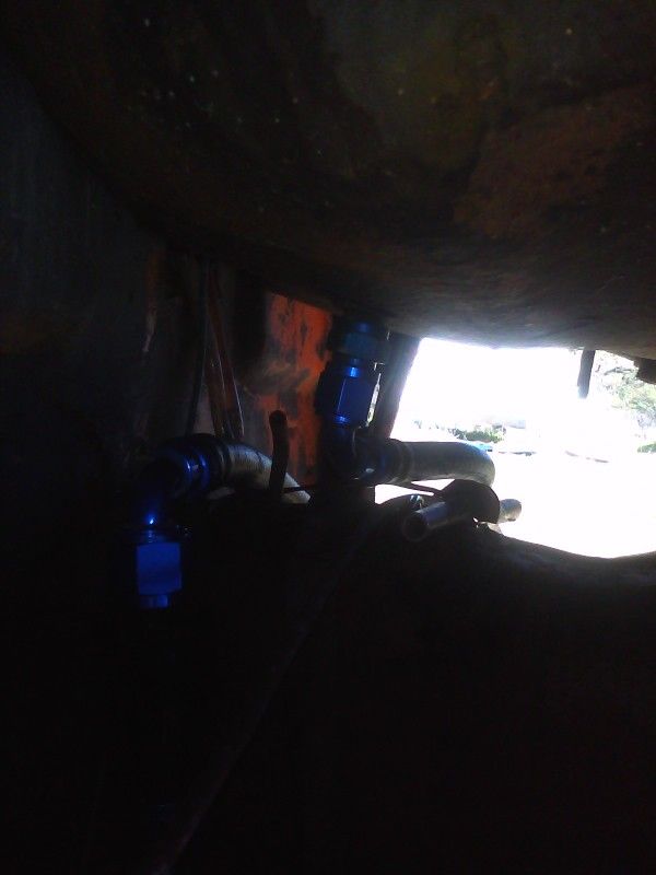

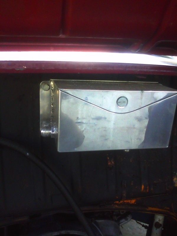

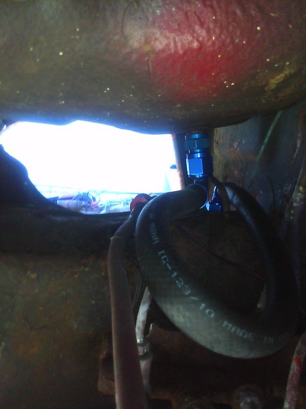

I use AN fittings Dash 10 I believe = 1/2 inch. here are a few pictures of my fuel "lines" I have 3 on the Ghia stock, 3/8" and 1/2" along with Holley huge fuel pump, filter and regulater and pressure gauge. Here ia also a 4 qt Breather box.
