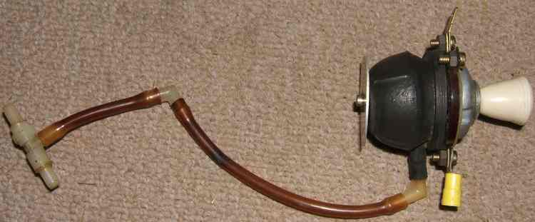

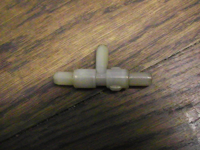

Has anybody got a t-piece for 1961 Beetle window washers (one year only). I works as a one way valve so when the switch is pumped it can suck the water from the reservoir and blow it up on the screen.
if you can't get the right VW part PJ, you can get a plain "T" piece and a separate one-way valve from Badshaws in Portlaoise. They have a box of these joints/connectors under the counter.
Its ok now I got my own one fixed. It's worked with two little balls that stop the water. One was missing and the lad in the bike shop in Portlaoise gave me a ball bearing and it did the job.
